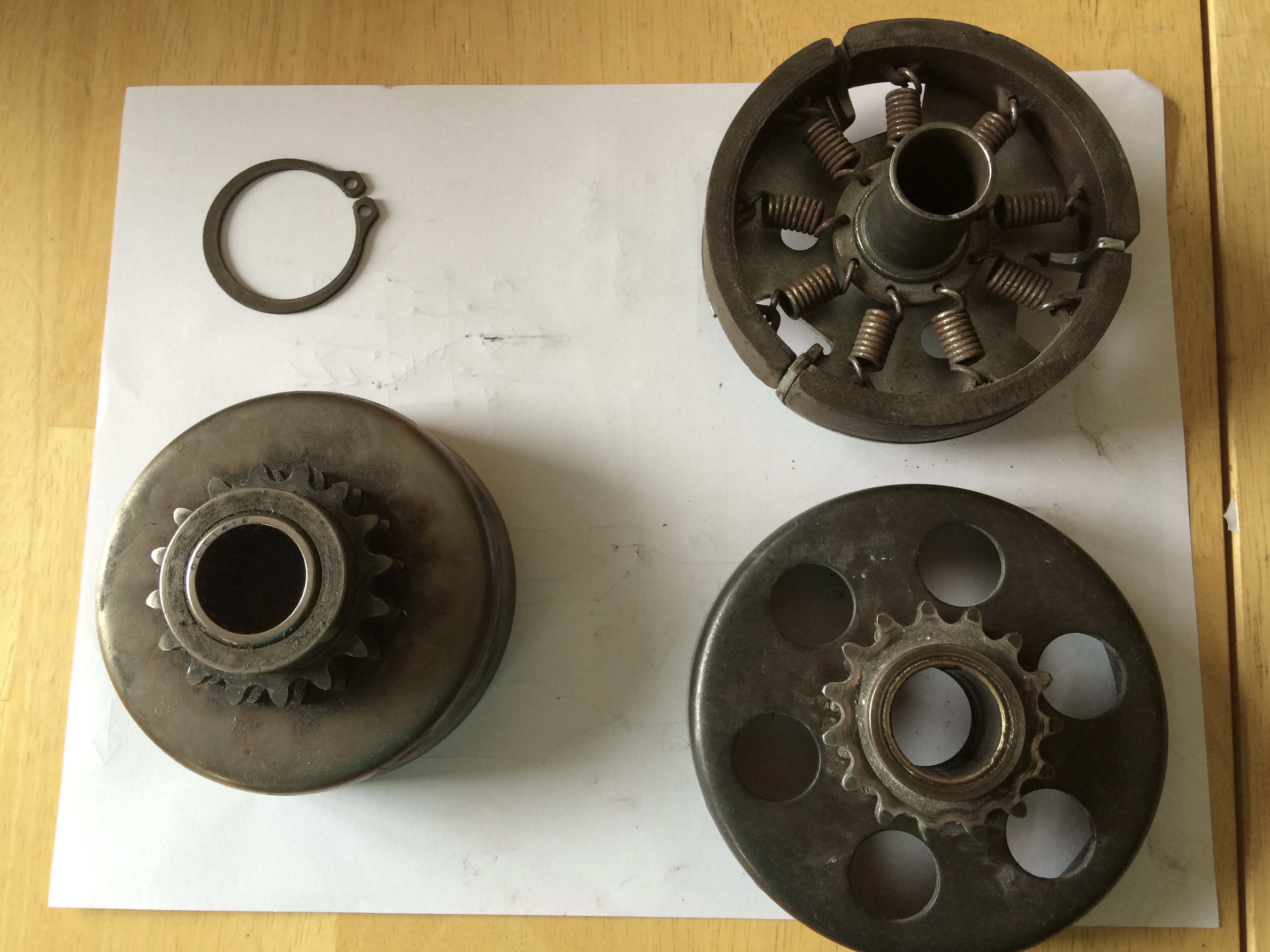

I am super green, and have the same question regarding gearing. Also regarding clutch.
I got a little seat time this last thursday, and didn't bounce off the limiter at any point, and fell pretty sluggish in the bottom end out of the corners.
So, gearing, clutch spec / manu, and float.
The float I will ensure is on point. But the other two I am unsure about. It's a used Kart, so I have no clue the type of clutch on it, has two shoes. I have a second clutch, four shoes.
Any advice, suggestions, starting points?
Thanks!
Jason

I have two of the solid drums, a 16t and 15t. and I have one complete set up with the vented drum / three shoe. (I was wrong, was a two shoe, and three shoe)
The solid drums have roller bearing, while the vented seems to be merely slip fitment?
Which of these two is a better unit? There are zero markings on either, they could be Chinese knock offs for all intent.

The solid cover/2-shoe clutch looks like a MaxTorque. Good clutch, but heavy for racing purposes. It will take a pounding though. if you can get this going with a 16 tooth drum, it would be fine for now.
The one with 3 shoes is a Draggin Skin. It's a competitive clutch but that one looks like it needs some TLC. You tune the engagement speed by changing the springs (they are different colours for different spring rates but those are old and dirty and it's hard to tell what the colour may have been). You will probably want to lightly sand the pads and the drum then clean with brake clean. It's important not to over-lube your chain because if lube gets into the clutch it will quickly glaze the pads. It would appear that it's a 15 tooth drive on that as well; you would want a 16 tooth for our track.
I would suggest that you get someone to have a look at it before you invest anything into it. It may make more sense to get one of the Hilliard Flame clutches which is what most of us run. IF your clutch can be cleaned up then roll with that for a while until you get some laps under your belt.
