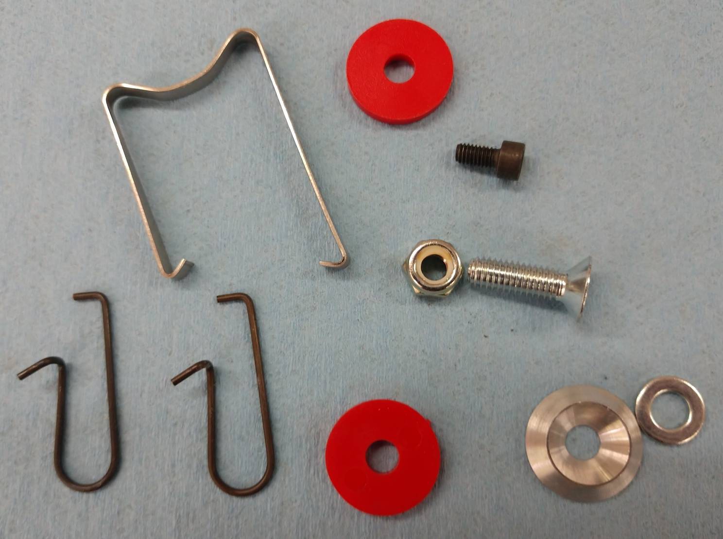

3. When I got done putting my go-kart together, I had a few extra parts :? I am not sure what they are or if they are important, but there were two wire clips in the bag I labelled engine and exhaust that might lock something in place that seem important. I also had a few new parts from Rok that are probably related to the battery but they look like floor tray bolds -- not sure what to do with those. I have attached a picture, please let me know if you recognize them.

Looks like your on the correct path with setting up the kart, in regards to the extra parts the silver clips/red bushings looks like its apart of the battery setup, if you have the manual it's shown on the bottom picture of page 11. not to sure about the black clips, next time im at the track i'll take a look.
The club has updated most of our regulations/registration process to compile with current COVID-19 measures so I would recommend reviewing them, As you might be traveling in from the US there could be a 14-day self-quarantine in place.
I'll update this post once I check out my kart, or maybe someone else may know those parts.
