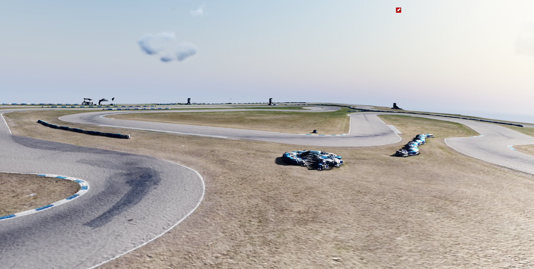

Sun got to me today :roll: didn't stick around for T&T.

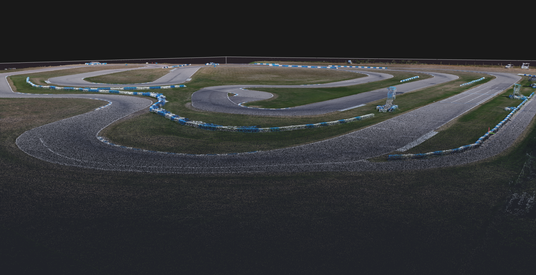

I tossed the manual flight images into the software the moment I got home and did the really basic "align" without any manually specified ground control points (I'll start working on them this evening) :D
first align.PNG (1.66 MiB) Viewed 89865 times

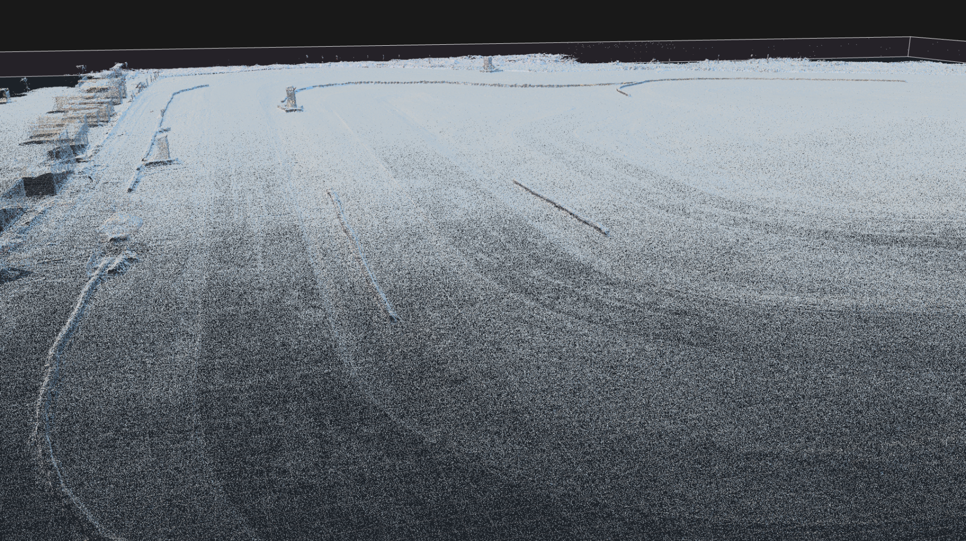

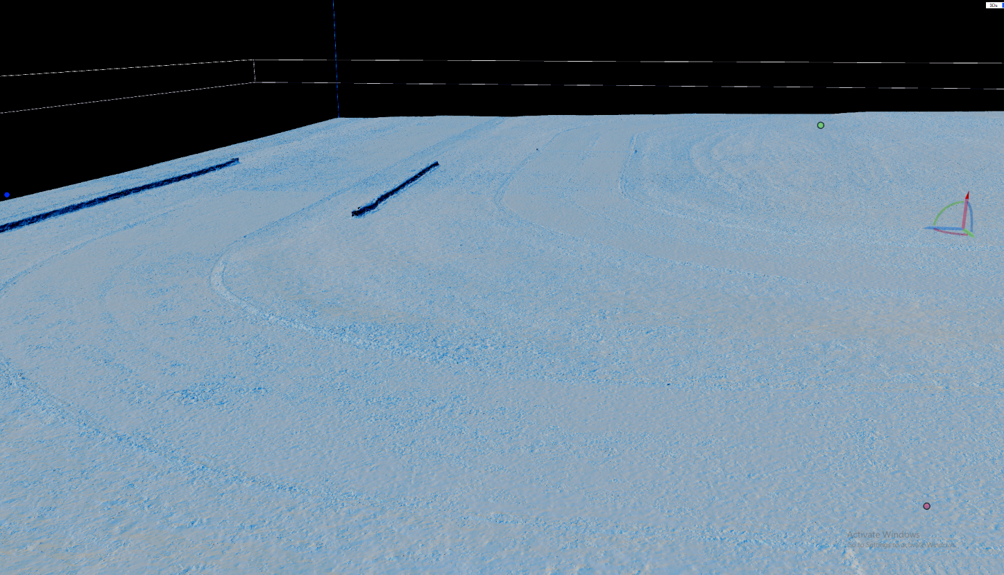

Then simply hitting the default automate all the steps and see what happens while I took a shower gave me this. Ignore the wavy ocean like mesh, that's a product of not enough manual alignment, RAW photo balancing, deleting errant points and the rest of the manual work still to come. Things like the barriers and marshal huts will have to be modeled outside of photogrammetry as it doesn't like generating those things in a "clean" manner. Also "cheaper" on performance to turn them into 4 sided boxes with some fancy textures/normal maps
Little bit of distracted manual refinement, going to need that round 2 of source photos with more stringent gimbal pitch / flight altitude to get "further"
dense basic denoise.png (1.94 MiB) Viewed 89853 times
The geometry is there, but I think I'll need some terrestrial photos or at least something under 50m altitude to get any texture detail

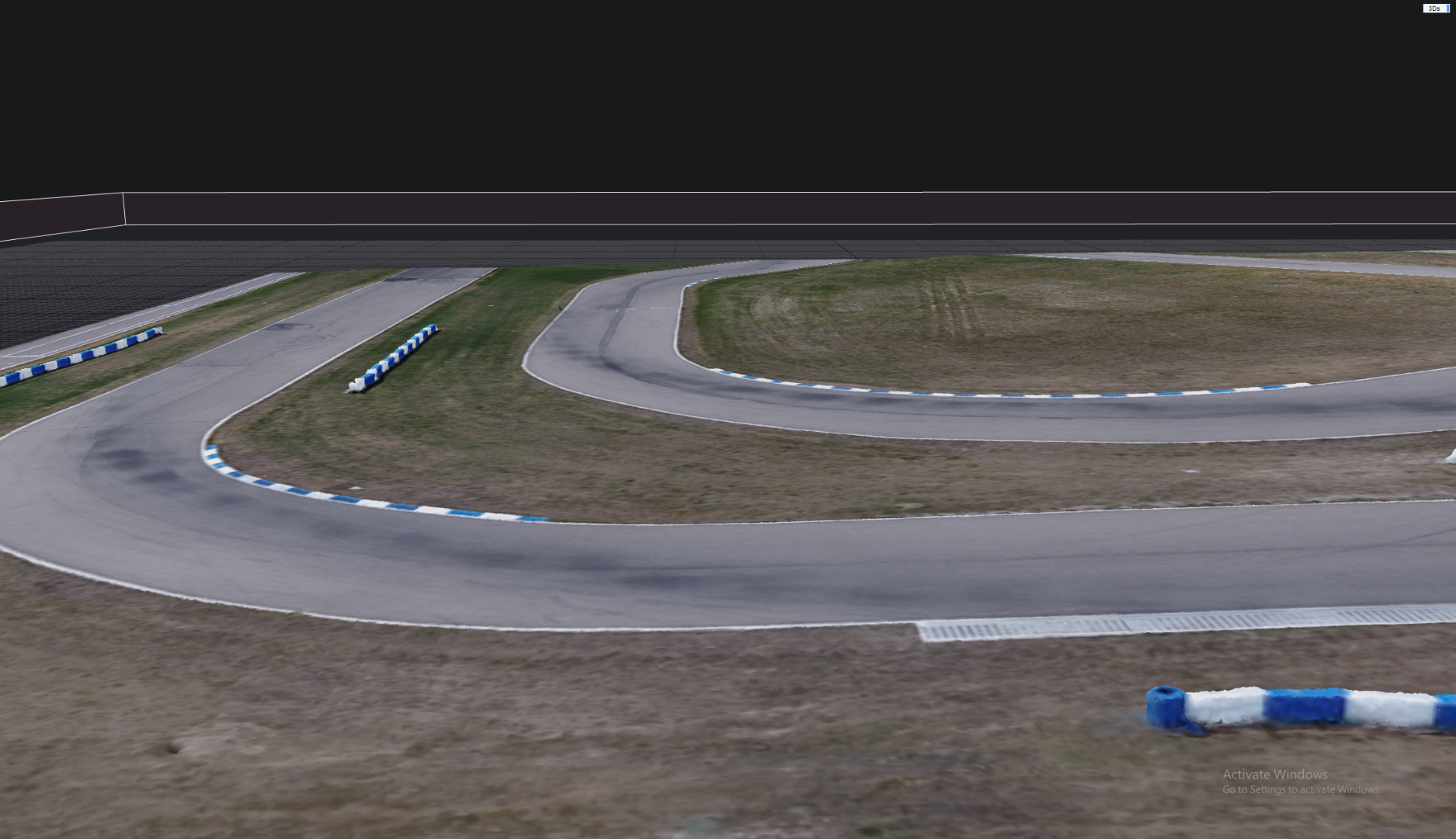

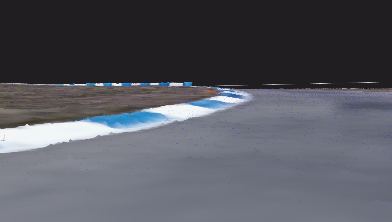

I'll need that round 2 data set but in the meantime practicing the workflow and learning.
This screen capture is from within the game engine's 3D editor (it takes the track object files I create with the photogrammetry and blender and helps finalize and convert it into something the game will be able to load)

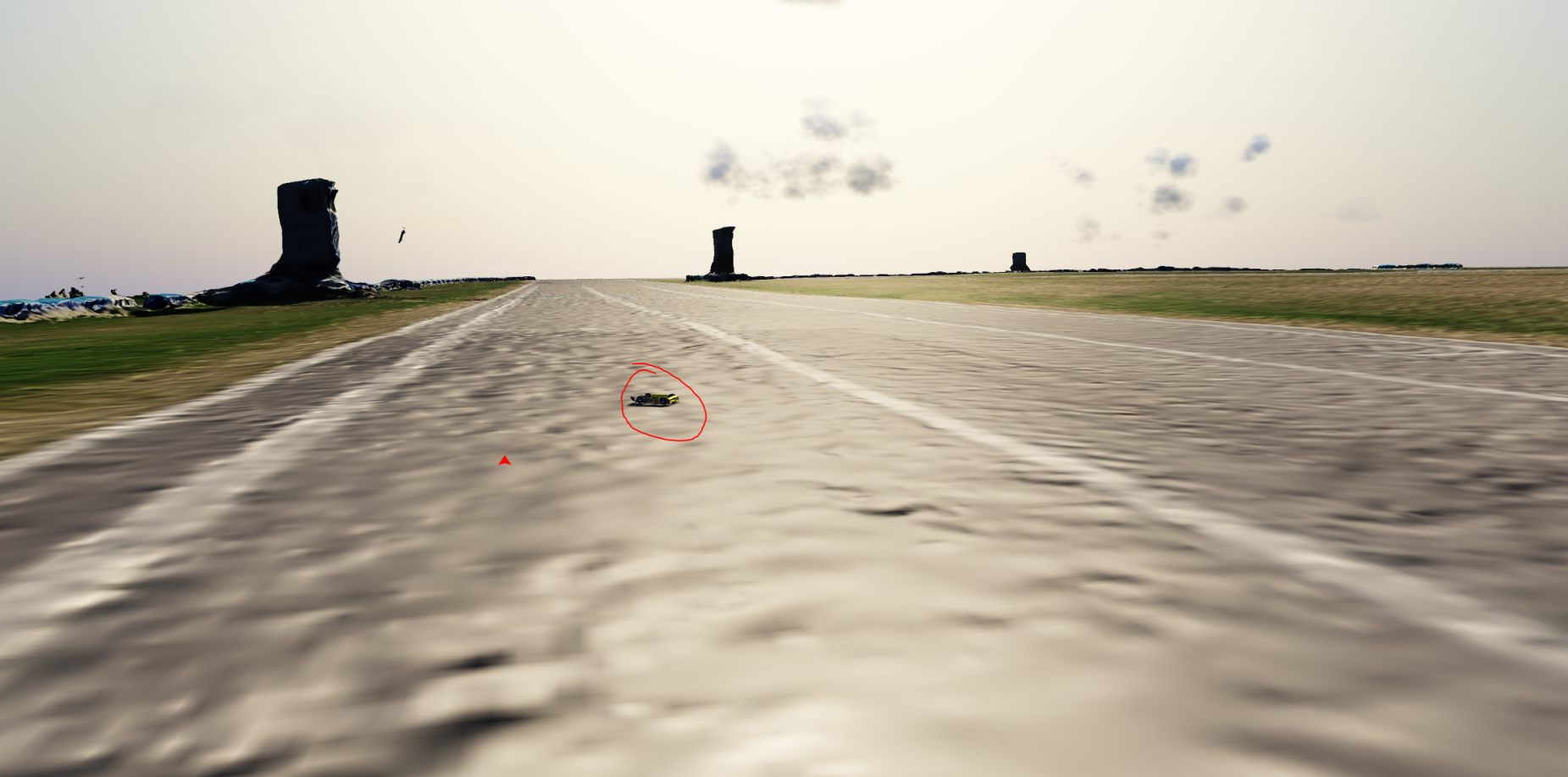

These two are from within the game it's self!! The shader settings (what controls lighting and shadows and the current washed out look) I simply plugged in some basic "defaults". Loaded it all up excited to realize I messed up by a decimal on the output scaling and the kart was "broken" and several factors too small
Fubar686
Posts: 18
Joined: Tue Apr 05, 2022 6:05 pm
First Name: E
Last Name: M
Re: Strathmore Motorsports Park Sim Track Project
Post by Fubar686 »
Oh boy, something that loads! (If you own Assetto Corsa and would like this alpha map you're welcome to to try it, I would love the feedback!! To cut down on google drive spam bots private message me and I'll be happy to share the karts/track files)
Road is very bumpy and hard to grip up on, textures and normal map are a blobby shadowed mess scattered across the ground but the new asphalt spots are there and visible and in future iterations we can add in a pseudo way of rubbering in and adding grip feel feedback though those areas and lines. There's some bad seams on my part between mesh parts causing the physics to launch you into the stratosphere in a couple of spots, but the scale... the scale :shock:
Through the VR headset already feels damn near 95-98% of the way there. The sim kart I'm driving there is closer to a VLR100 than the briggs I'm used too but it all feels "correct" so far
*oops this is why I'm testing, looks like I smoothed instead of de-noised on the z axis and the height difference between the highest and lowest points of the track might be off by ~10%. Something to note for next time..
