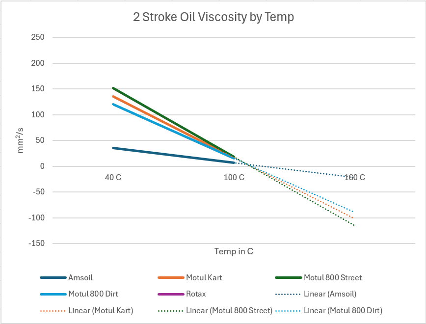

I also wonder if the viscosity is linear or not. I put what little data we have into an excel graph, much like what you drew up.

Yes. Viscosity is linear, but on a logarithmic axis. Instead of your lines being 50,100, 150, they’d be 2,4,8,16… to get straight lines.
