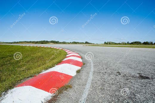

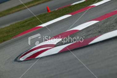

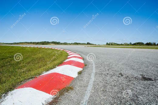

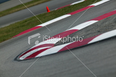

What I have noticed on most modern tracks in Europe is that they are building curbs with a drop-off on the backside to discourage driving beyond the curbing. With this design excessive abuse of the curbs is higher risk to losing time and stability on exit. This also keeps drivers in line who are always looking for the shortest possible way through a corner.
round curbing.jpg (43.74 KiB) Viewed 13209 times
I do not see any reason to change this corner as has been suggested at this time. We must remember that this track has to remain interesting and challenging for all of the classes racing. When we designed the track, this section was discussed greatly and the previously proposed layout change in this discussion was one we looked at but later went with the layout we built.

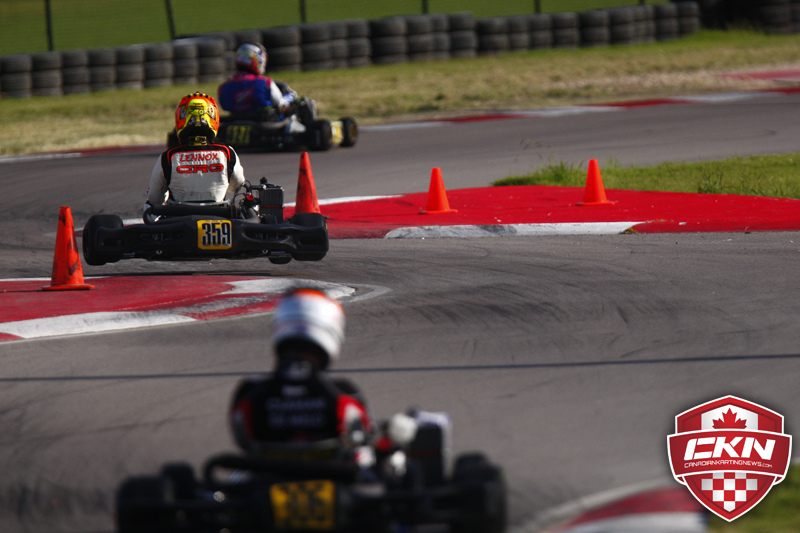

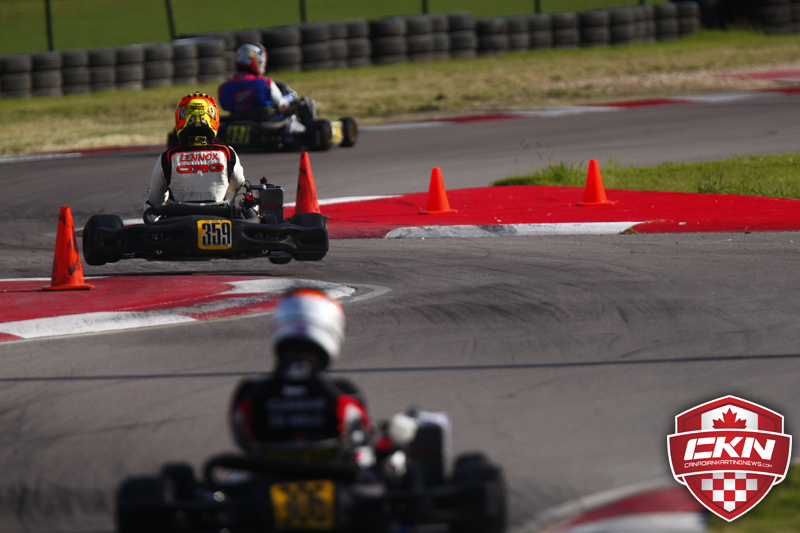

Our main concern with the chicane as it has been built was that we would be building a chicane that would be abused like many other tracks. The tracks with problem chicanes typically tied two fast sections together with a chicane as a mechanism to slow the drivers. The intent to slow the area down was there but the execution proved different and NOLA motorsport park is a prime example of bad execution.
NOLA curb jump5.jpg (183.83 KiB) Viewed 13209 times
As you can see, their solution was to concrete everything, which was another mistake as it made it easier to cheat. These curbs were later removed completely and a straight flat section was put in, negating any challenge whatsoever.

- "concreting" over curbs, or making them flatter, risks making it worse not better, as this will just cause us to cut further (great photo from NOLA though)
