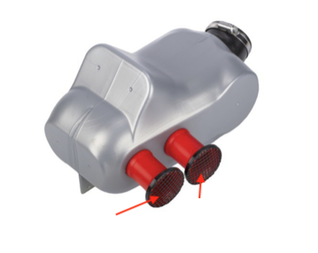

We aren't allowed to cut out those screens, are we?
VLR #42
Re: Vortex VLR 100 - FAQ
Screen Shot 2021-03-26 at 3.34.28 PM.png (77.95 KiB) Viewed 37489 times
Those black screens are useless except to keep out rubber and you do not have to run them.

I was told that the plastic airbox screens shouldn't be used because they restrict airflow. One person who told me that is a tech that works for ROK USA and he said it would make enough difference to need to change jetting. I haven't seen anyone in any class using them here.
