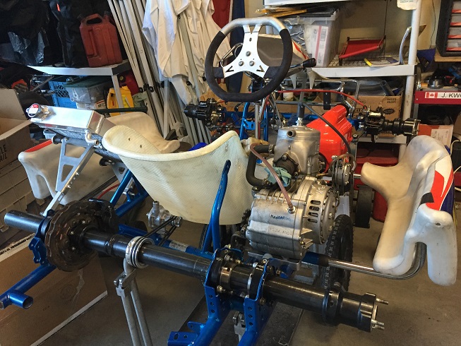

Added Motor, front hubs and bodywork.

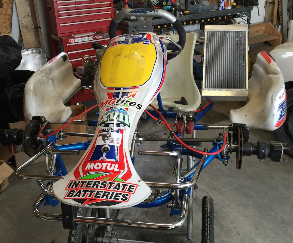

Front View

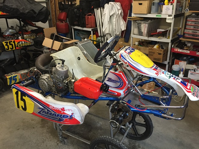

Side View

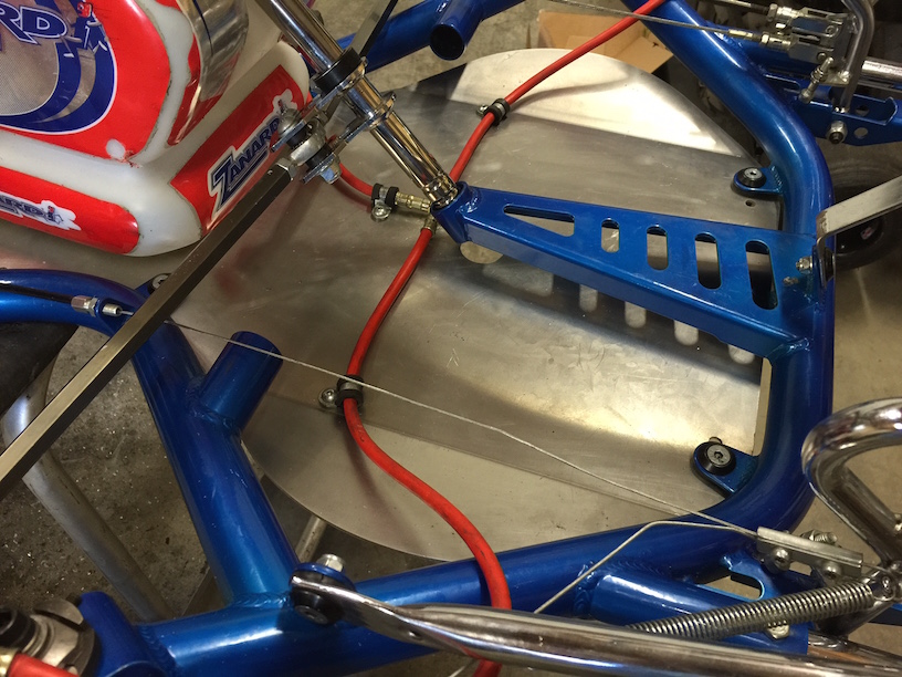

Forgot to place front brake lines under the bumper and the steering shaft. 3 bolts to loosen and fixed. Floorpan is only a used one I had. Still have to fabricate a new one.

Posted: Mon Mar 23, 2015 9:49 am
by Bainesy36
Really like seeing ground up builds like this, on any vehicle. Looking forward to seeing this completed (very soon by the look of it ;) ), then seeing it for real on the track.
What engine are you using John?
Re: Shifter kart build
Posted: Mon Mar 23, 2015 10:03 am
by John Kwong
TM K9B
Thanks. The big things are getting done. I still need to source a few things and then do the set-up.

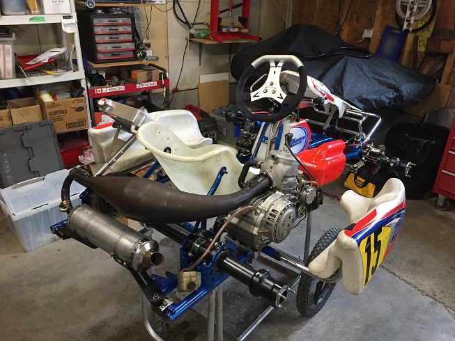

Axle installed with brake system and water pump

Carburator, airbox and throttle cable installed
Photo 2015-03-20, 3 11 00 PM.jpg (178.22 KiB) Viewed 13103 times
Exhaust system and mounts
Photo 2015-03-20, 3 11 09 PM.jpg (161.78 KiB) Viewed 13103 times

Haven't had much time lately to spend on the build but here is a photo of the floorpan installed and the brake line keepers.
