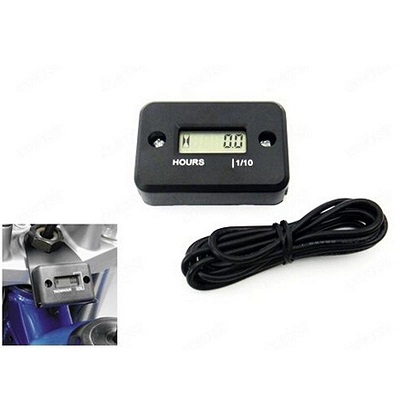

This past year I wanted to know and have an accurate record of the hours that were being put on my engines. I searched the internet and Ebay and found these as an inexpensive (less than $6) way to monitor engine running hours.
hour meter_sm.jpg (26.29 KiB) Viewed 5671 times
I was surprised to find that I wasn't putting on as many hours as I thought each season. This year in Rotax Senior I ran 11 club races, 2 out of town races (AB Shoot-Out) and 4 T&T track days for a total of 6 hours running time. Previously, I was guestimating that each raceday was putting on about an hour of time on the engine. The MyChron 4 does have an hour meter on it but it needs to be re-set each time you get your motor re-built and it is not readable at a glance of your kart.
Here is a link to this device: http://www.ebay.com/itm/New-Waterproof- ... 1296986880

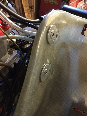

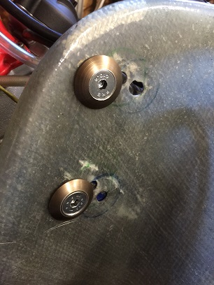

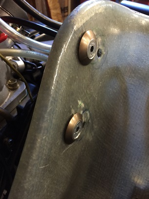

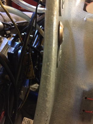

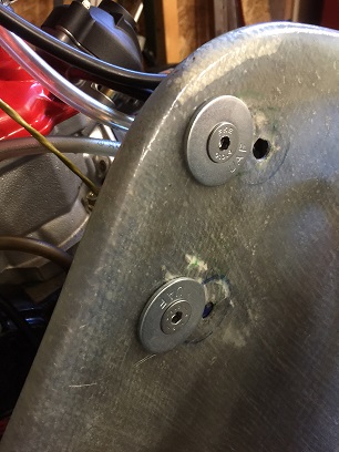

Even after 35 years of kart racing, there is always something new to learn. I suffered with some rib pain this year and narrowed it down to these awful countersink seat washers. I had purchased a better rib protector this year and it still didn't help. After seeing Peter Sammon's karts set-up with flatter washers, an "aha" moment happened. I have now tested this for myself and can report that my rib pain is not a problem anymore.
Before with normal countersink seat washers
New flatter washers from Lowe's
Comparison of old vs new washers
