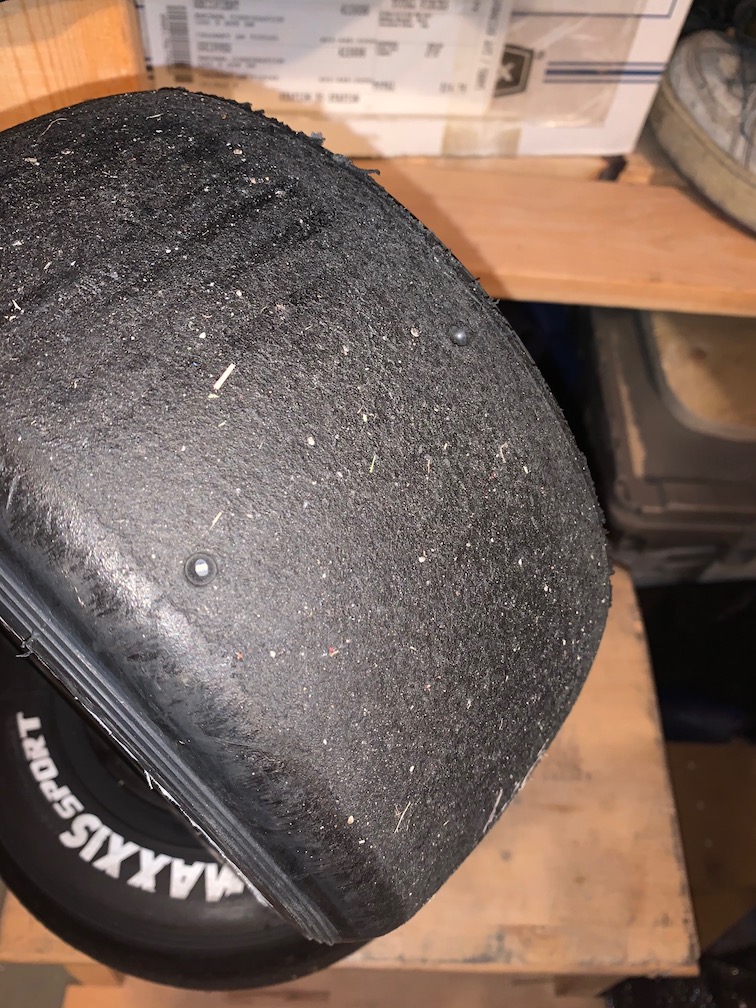

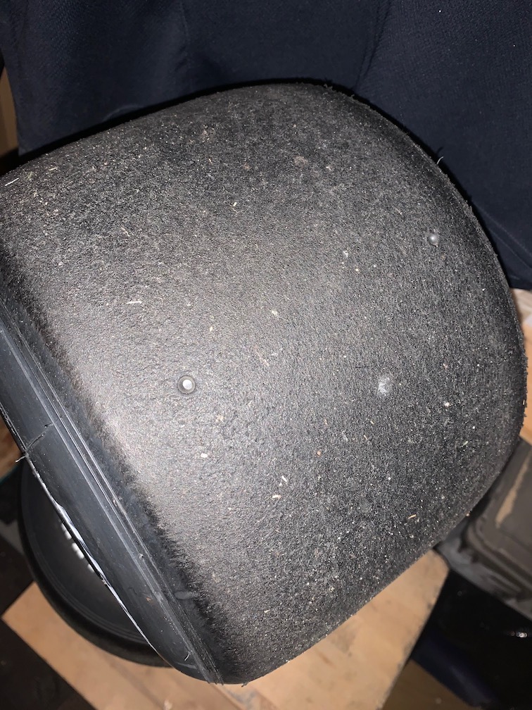

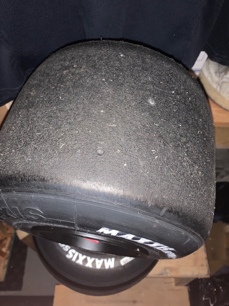

Here are the pics I took today of the tires after 190 laps of use on my DC-One/Briggs entry (5 laps of practice, 171 in the enduro and 15 laps on my shifter).
Each raceday we do a maximum of about 40 laps. These Maxxis tires still have a ton of life in them and did not fall off at all.

I understand the argument for wanting to use a tire that another class uses to be able to economize between Briggs and VLR. I did this myself when the Briggs were last on the Mojo tire. I can see the Vega Green possibly going away and the Briggs will be on the Mojo to coordinate with EDRKA. The only advantage I see to the VLR class following Briggs onto the Mojo is local availability. I think using the MOJO D2 with the 7.1 rear will be a lot more grip for the VLR than they had this year.
When I tried these Maxxis tires on my shifter they were slower to warm up than Vega Whites which was to be expected but the grip level did come in and I was able to do very competitive laps with a best of 53.03 on a T&T night level of grip. I did 3 sessions of 5 laps each. After doing the testing on my shifter the Thursday after the enduro, I realized that we ran way too much pressure at 12 front and 13 rear. I torture tested them and went down to 7 lbs in the front and 9 lbs in the rears to see if I could get them to overheat which they did not. They just kept getting better.

Hi Don,
I think the Maxxis Sport would be fine for what you have planned. Putting these tires on my shifter was purely out of curiosity to see how they would perform and if they would degrade or start shredding from the extra abuse that a shifter puts on a tire. Considering these tires already had 170+ laps on them, they performed better than Vega White tires that had 80 laps on them. So, I was driving on these at what would normally be considered past their prime time while achieving competitive lap times and the kart still felt pretty balanced handling wise.
