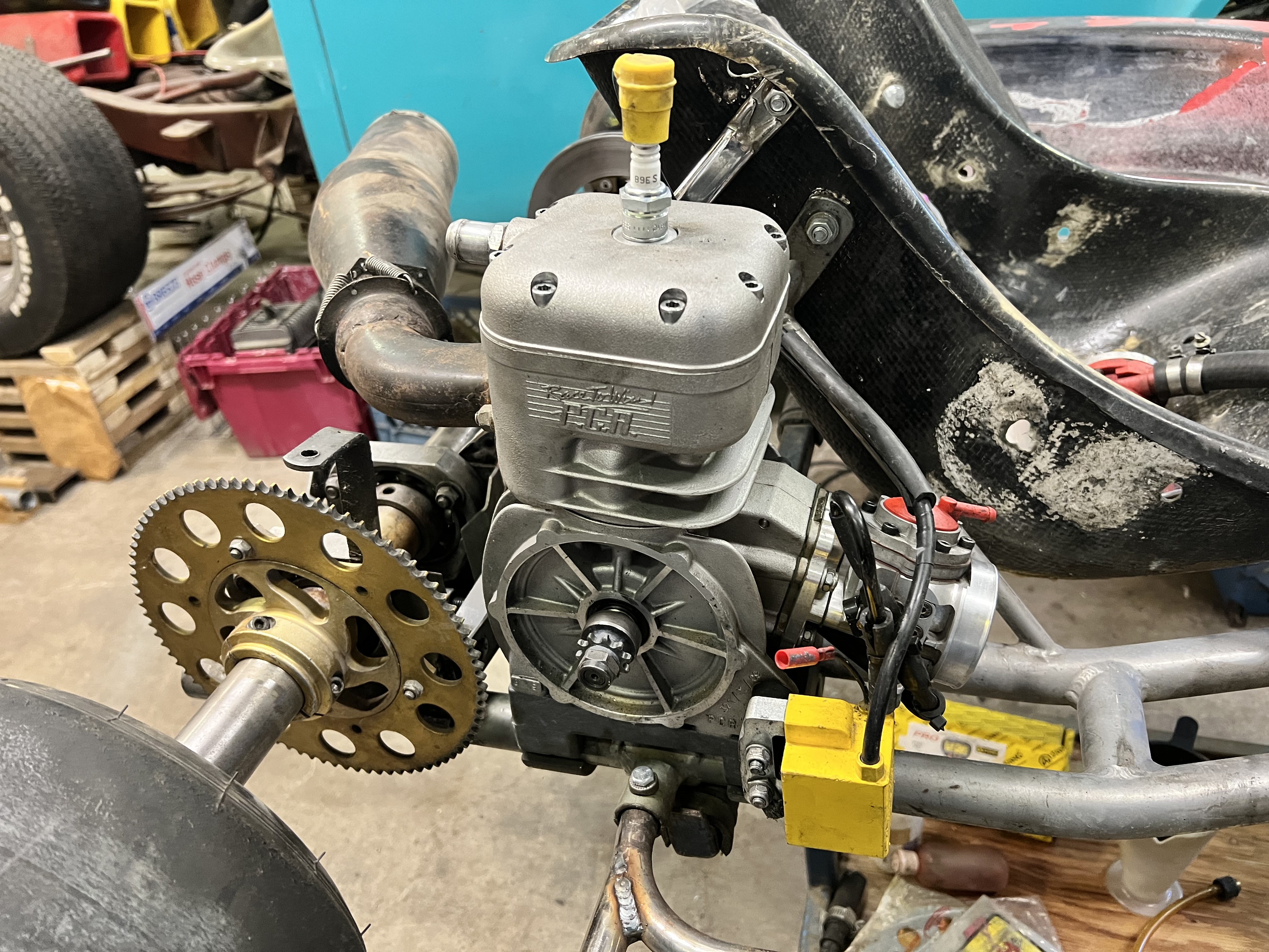

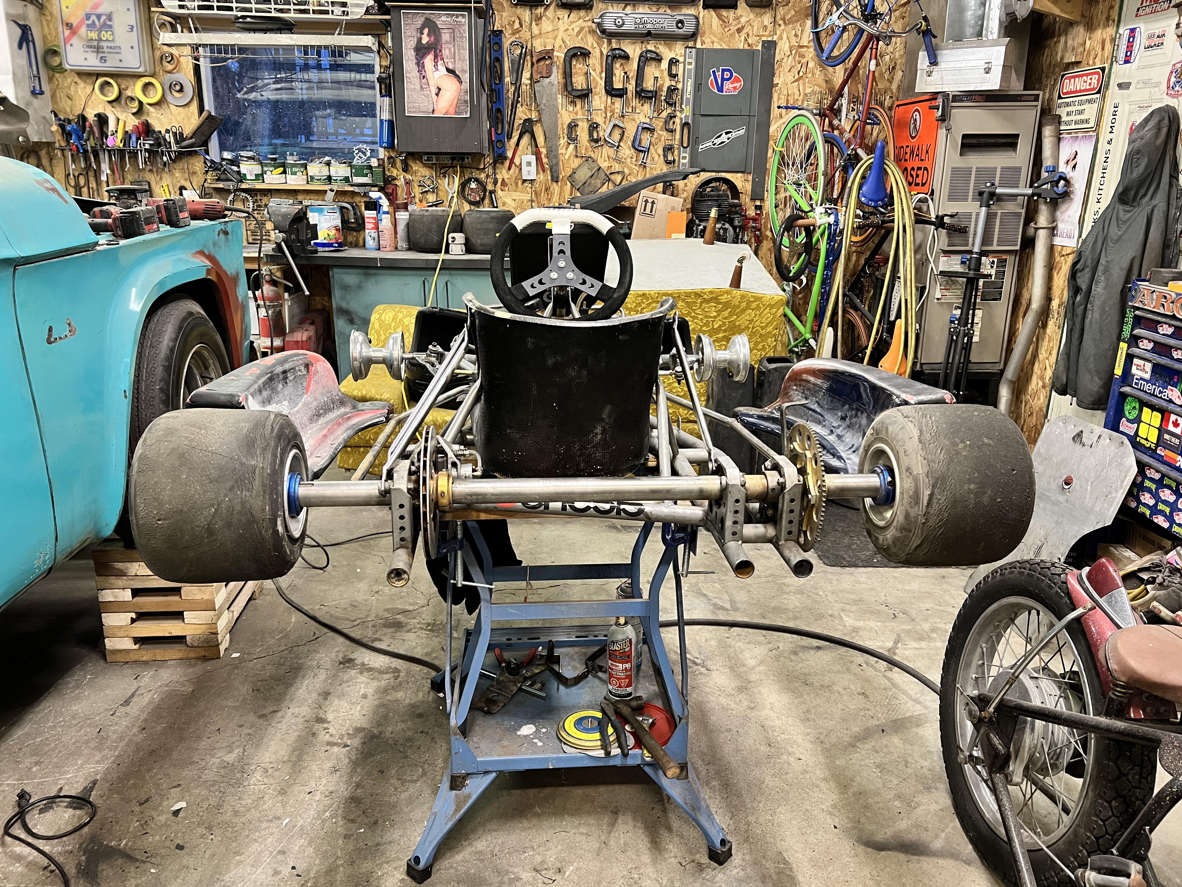

Hello, my name is Chris. Im new to karting. I bought a basket case PTK kart, and a bunch of boxes of spare parts. I have this engine that I can’t seem to ID with my searches online. I don’t know if I can even run it on the track. Any help would be appreciated!

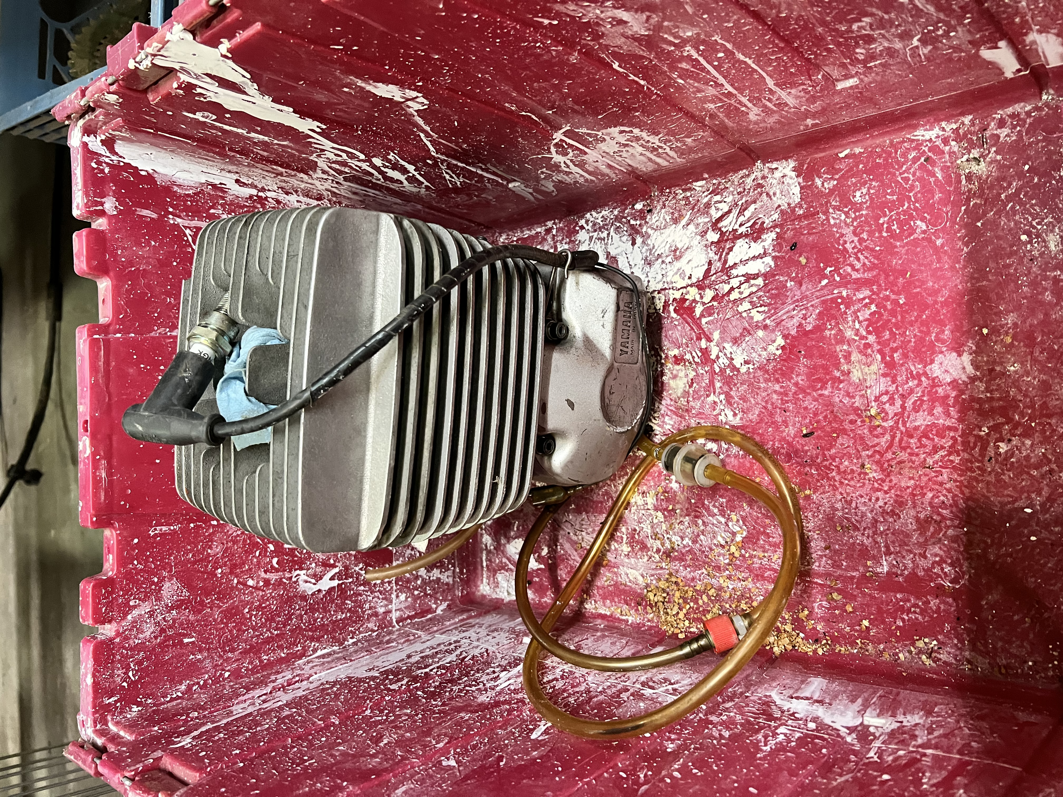

I also have these 2 Yamaha engines. Are they useable, or too old? Sorry, these may seem like dumb questions…

Hi Chris,
Welcome to karting!
The liquid cooled engine is a 100cc PCR direct drive motor that was raced around 2000-2003. You would need an axle driven water pump and a radiator to run that motor. The 2nd motor is a 100cc Yamaha KT100SE with a centrifugal clutch and 3rd bearing mount and these were raced from 1980-2002. The third motor is also a Yamaha KT100 but is an older version due to the lack of rubber dampening on the fins. The CKRC does not currently run any of these engines at their race events but you could run these engines at Test & Tune practice events or in the annual 3 hour enduro race.

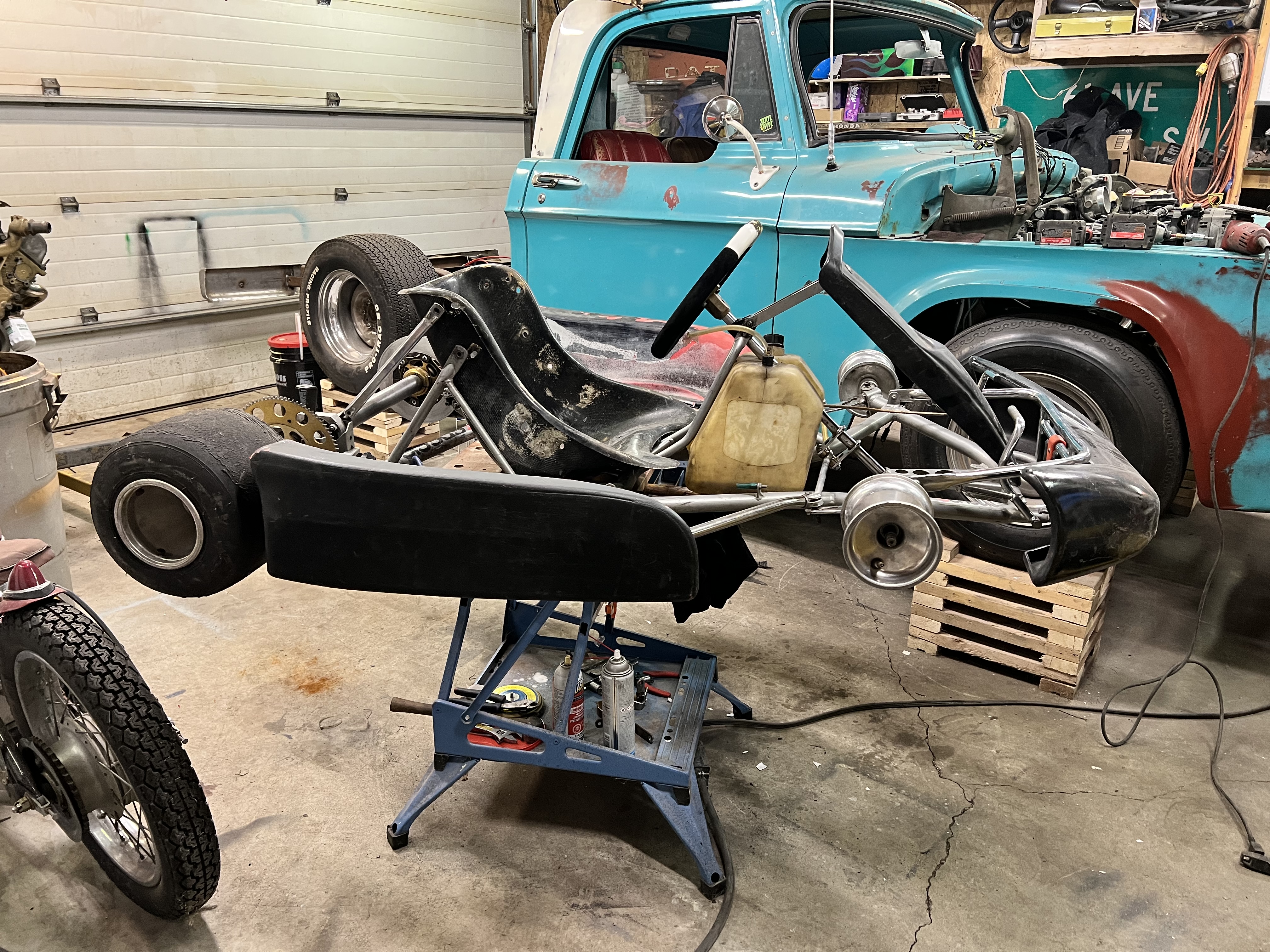

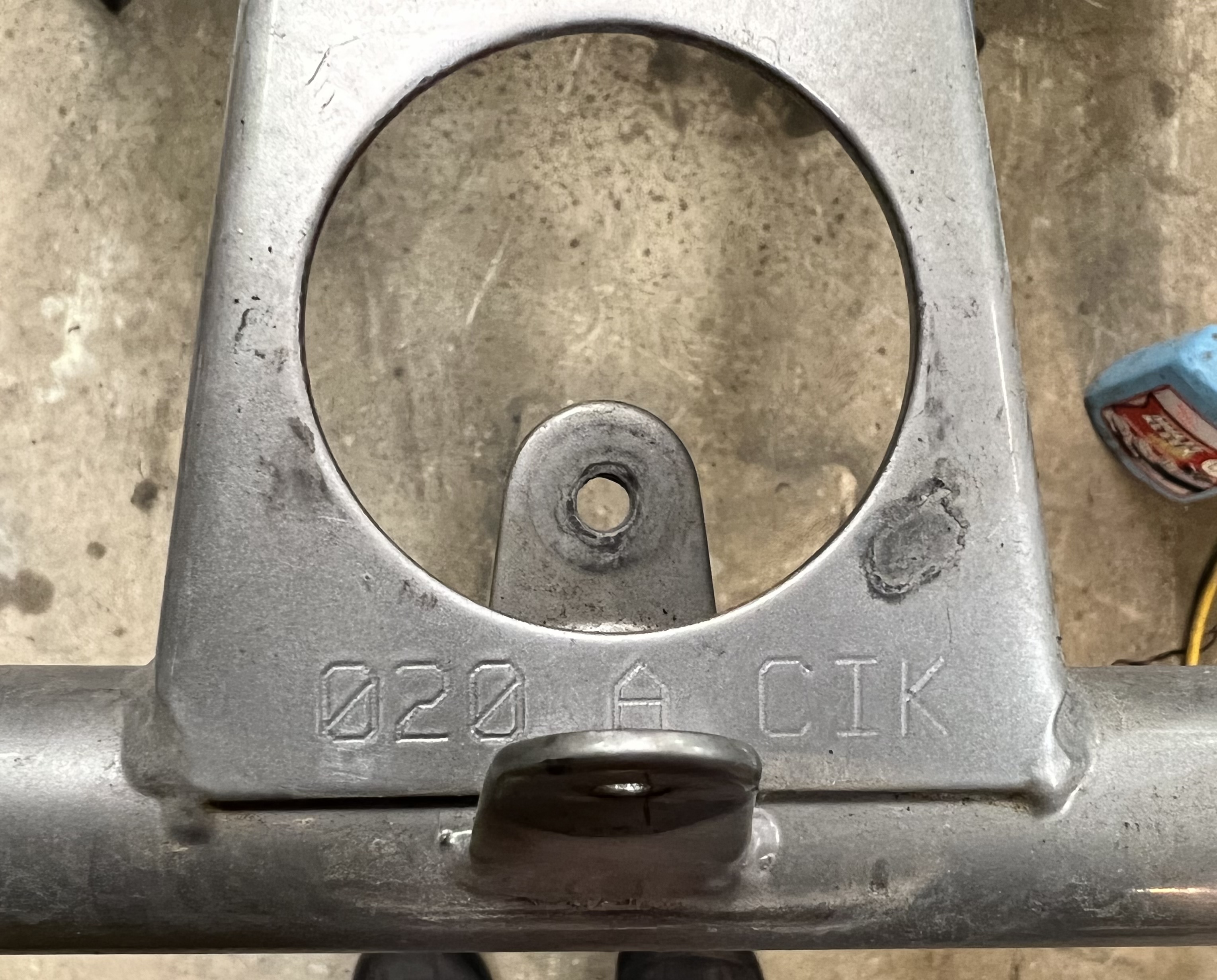

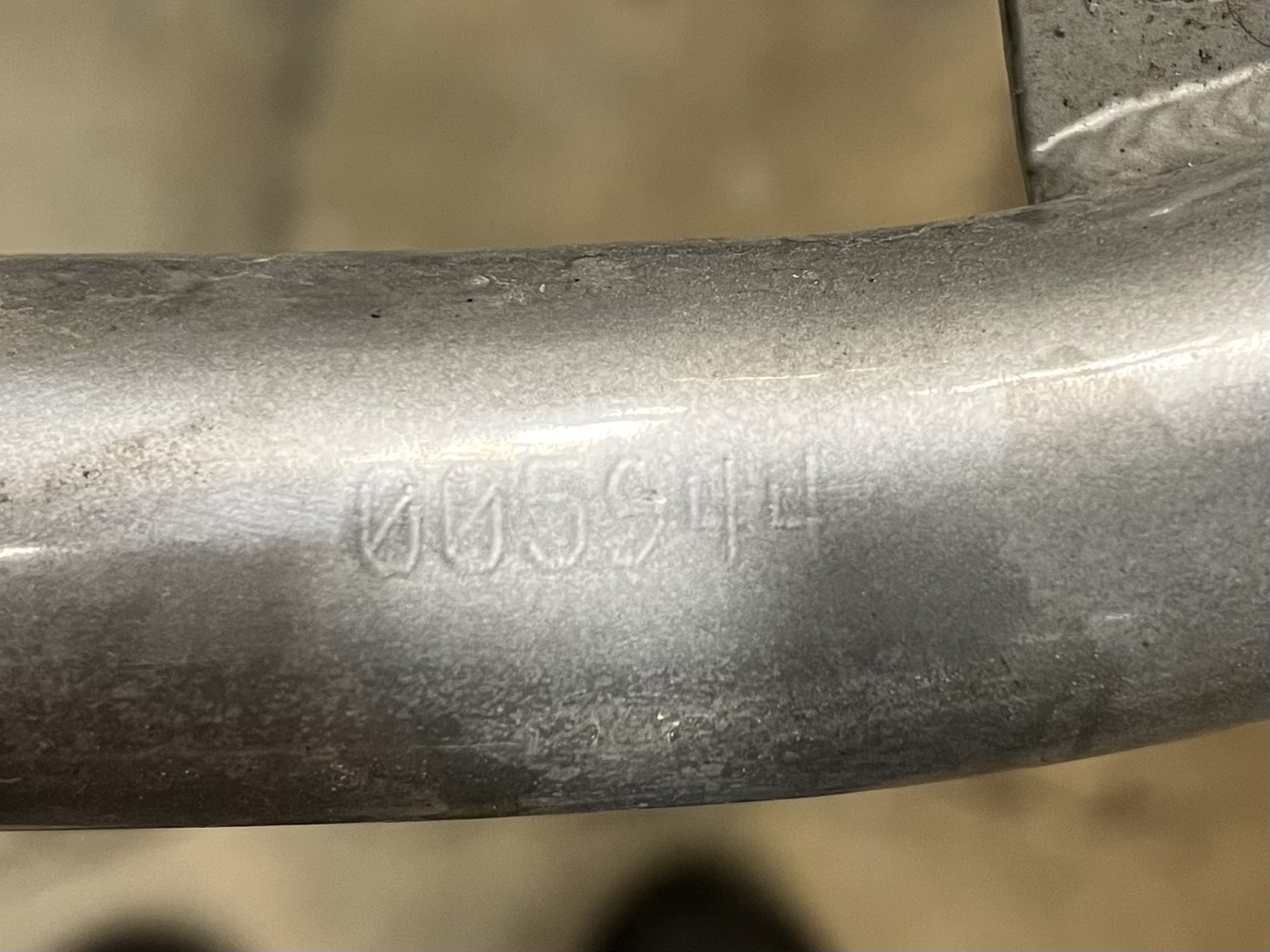

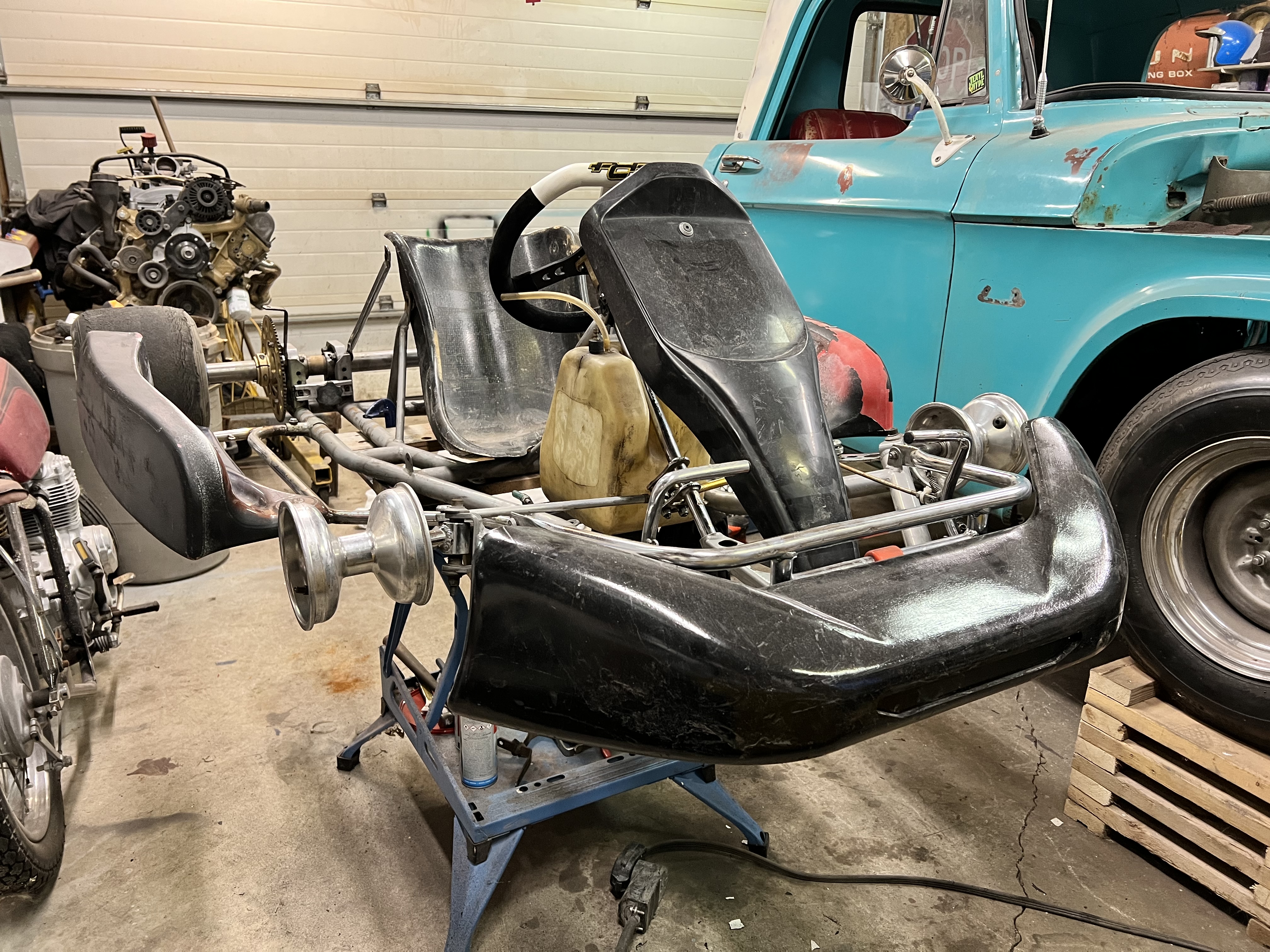

The chassis vintage is before 2003 as the sided attachment on the front of the chassis is on the "A" arm yoke and not on the side near the gas tank. There is usually a chassis tag on the crossbar behind the seat that identifies the brand and model of the kart. It looks to be an older PTK or Paul Tracy Kart that was manufactured by CRG. Other than the brakes, many parts are interchangeable between manufacturers.

Thanks for the reply. I appreciate all the info! I do have the water pump, rad, etc for the pcr. The direct drive thing seems like it would be a bit of a pain. Is there a way to run a clutch somehow? Or would the kt100 be more fun?
Yes, it is a PTK chassis, from what I was told. There is no tag that I can find, only the letters/numbers on the front. I was able to disassemble the brake, clean it all out and got it working again. I threw the kt100se on there and got it running. It seems to run great. I can’t seem to get the clutch to slip at all (the engine will stall if the wheels stop) I disassembled it, read the manual, reassembled/adjusted it, and still no luck.
