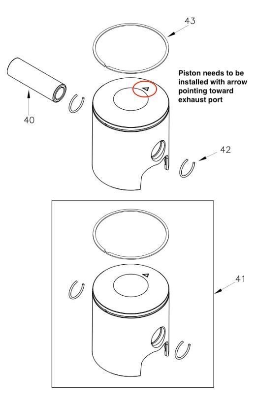

For those that decide to do their own motor re-build work on the VLR motors, there are a few notes to know to avoid trouble. First up is the arrow on the top of the piston. This arrow ALWAYS refers to the direction of fuel through the motor and MUST point toward the exhaust.
Top end re-build NOTE
