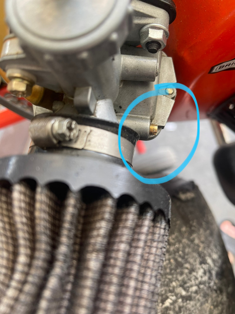

Have a question about the Briggs L206 idle ̶s̶p̶e̶e̶d̶ mixture screw. I had one fall out while driving already and the replacement doesn't seem to fit right.
The Problem:
  • Even when fully screwed in, the new replacement screw still sticks out a lot. I tried leaving the spring out but have the same problem. See picture for example of it fully seated.
What I'd expect:
  • I'd expect the screw to sit pretty close to flush when screwed all the way in.
Potential problems:
  • It looks like there might be a broken spring inside the barrel that's preventing me from turning the screw all the way in. (A bit hard to see but I attached a couple pics)
  • If it is a broken spring inside, it's in really solid and I can't remove it.
Just wondering if anyone has ideas and whether those internal threads are supposed to be there?

That is the air mix screw; idle is the larger one.
Have a look at this:

Oops I made a mistake when writing it up. I think this should be the right part based on the manual you linked.
Screen Shot 2022-05-23 at 2.34.27 PM.png (527.96 KiB) Viewed 33876 times

That is the old spring inside. It doesn't look broken. If a pick won't get it out, there are two options - use an ultrasonic cleaner to clean the carb, and it will likely come out, or just use the new screw with the old spring, and leave the new spring out.
Phil

Managed to dig the old spring out. Thanks for the help.
