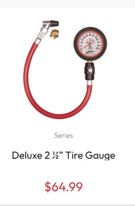

You’ll want a gauge that is fairly precise. Something that rounds to just the nearest PSI - or even half PSI - isn’t quite good enough when you’re inflating to the low teens.

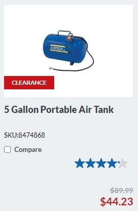

I agree with Jason. A bike pump is not ideal. A 5 gallon air tank is great and you can fill it at the track. You will be able to top up 4 tires in mere seconds.
Princess Auto and similar are places for that. You will want at least a 4-foot hose and a decent chuck. One of the coiled hoses are good.
Also, for a gauge you will want something that is meant for racing. 0-30 psi is a common range. Also, if it has a bleed button on it, that is useful. We invested in a Longacre racing gauge over 20 years ago and it is still going and is still accurate. $65 USD on their website. You will never regret getting the right tools!
