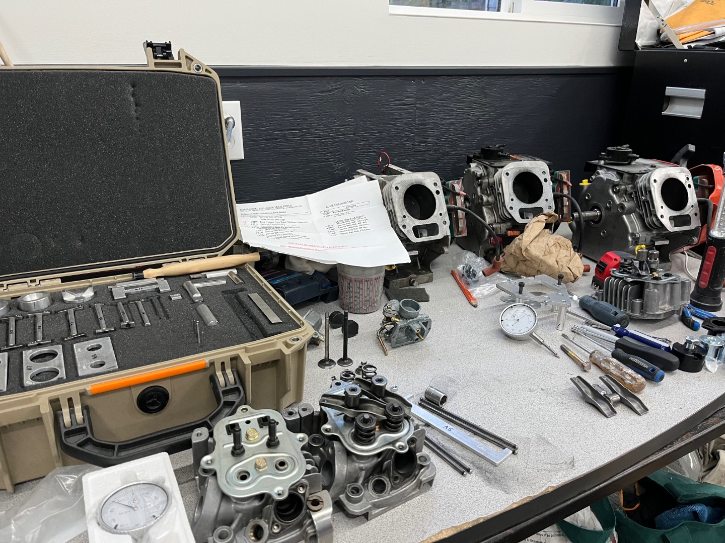

I measured things

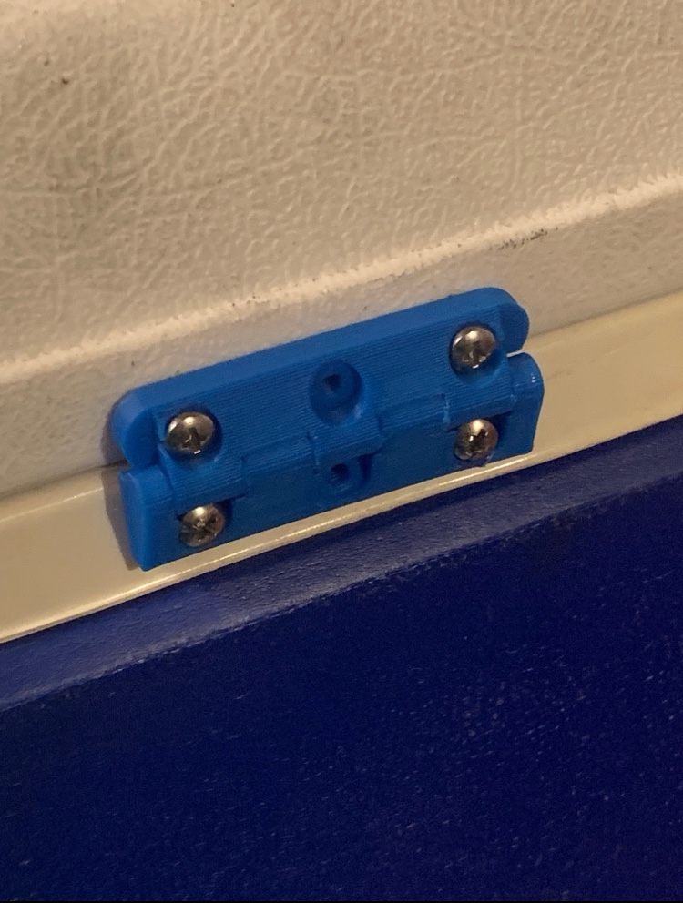

I 3D printed new hinges for my race cooler.

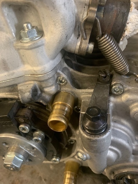

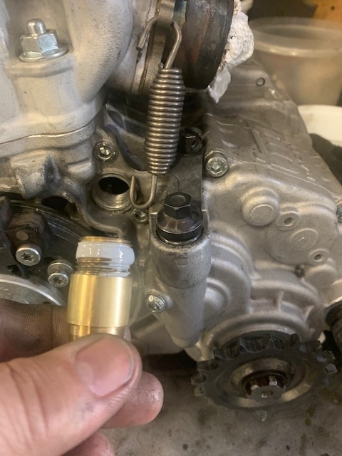

Today I worked on my shifter kart. I fixed a loose shift lever linkage by replacing a ball joint. I sourced a water leak on the motor which was a loose threaded lower insert on the transfer passage from cylinder to the case. I removed the seat from the kart in anticipation of trying a stiffer style seat and I removed the motor mount plate and cleaned the lower fins of the motor of dirt, grease and rubber build-up which should help with cooling.

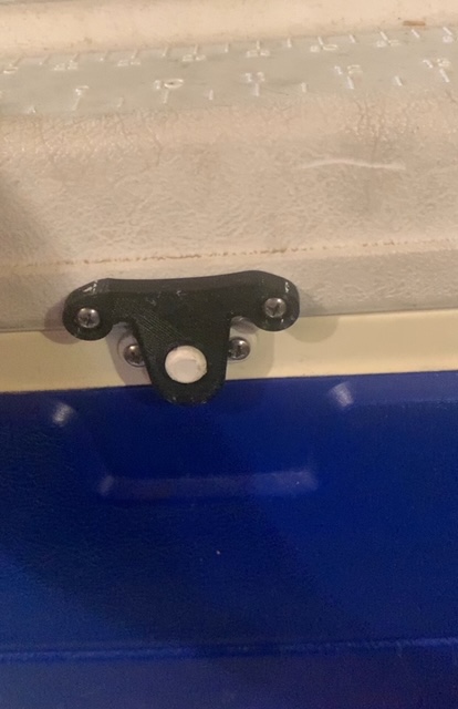

I also 3d printed a flexible latch out of TPU for the cooler that broke years ago. [attachment=2]
