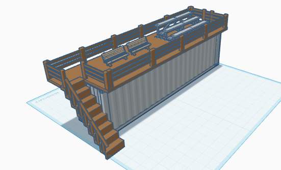

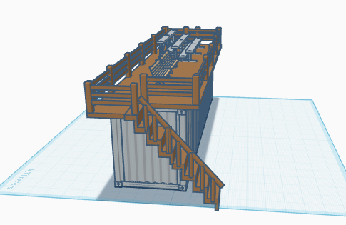

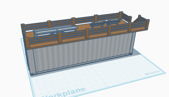

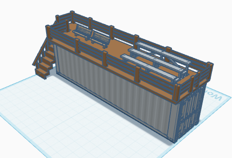

Hi All,
The idea of having a viewing platform built on top of the seacan that is between the Pre-grid and the timing tower has been floating around for a couple years now. Now that the track re-paving has been completed, I thought that this might be a good next project to improve our facility. Below are some conceptual CAD drawings to flesh this idea out. I have no idea on material costs and perhaps the Trims could give some insight on their experience in building their platform. We would probably need engineering drawings and a building permit from the Town of Strathmore. Please add your thoughts and comments.

John this is awesome. I really like the idea of making use of unused vertical space. I would like to see this get built. The drawings are pretty good. Maybe a double set of bleachers rather than a bench, to add more seating?
I wonder what considerations for safety. would need to be taken into account, if high bleachers are used, but im sure its not nothing we can't do.

I believe the sea can is owned by AMRA, so we would have to clear it with them. I like the idea, but I recall there being concerns about losing visibility to pre-grid from the tower when it was previously discussed.

Yes, I forgot that AMRA own that seacan. Shipping containers generally do not have a lot of structural integrity on the ceiling and I was thinking that this deck structure would most likely have to be somewhat freestanding around the seacan. As this is just a conceptual idea drawing, I forgot to put legs for the deck. Alternatively, if visibility of the Pre-Grid is still a concern, this could be done on the seacan to the west of the timing tower.

I was thinking the same, as far as legs, and mostly freestanding. It could likely be fastened to the container by the shipping tie downs on the outside corners to add some ballast.

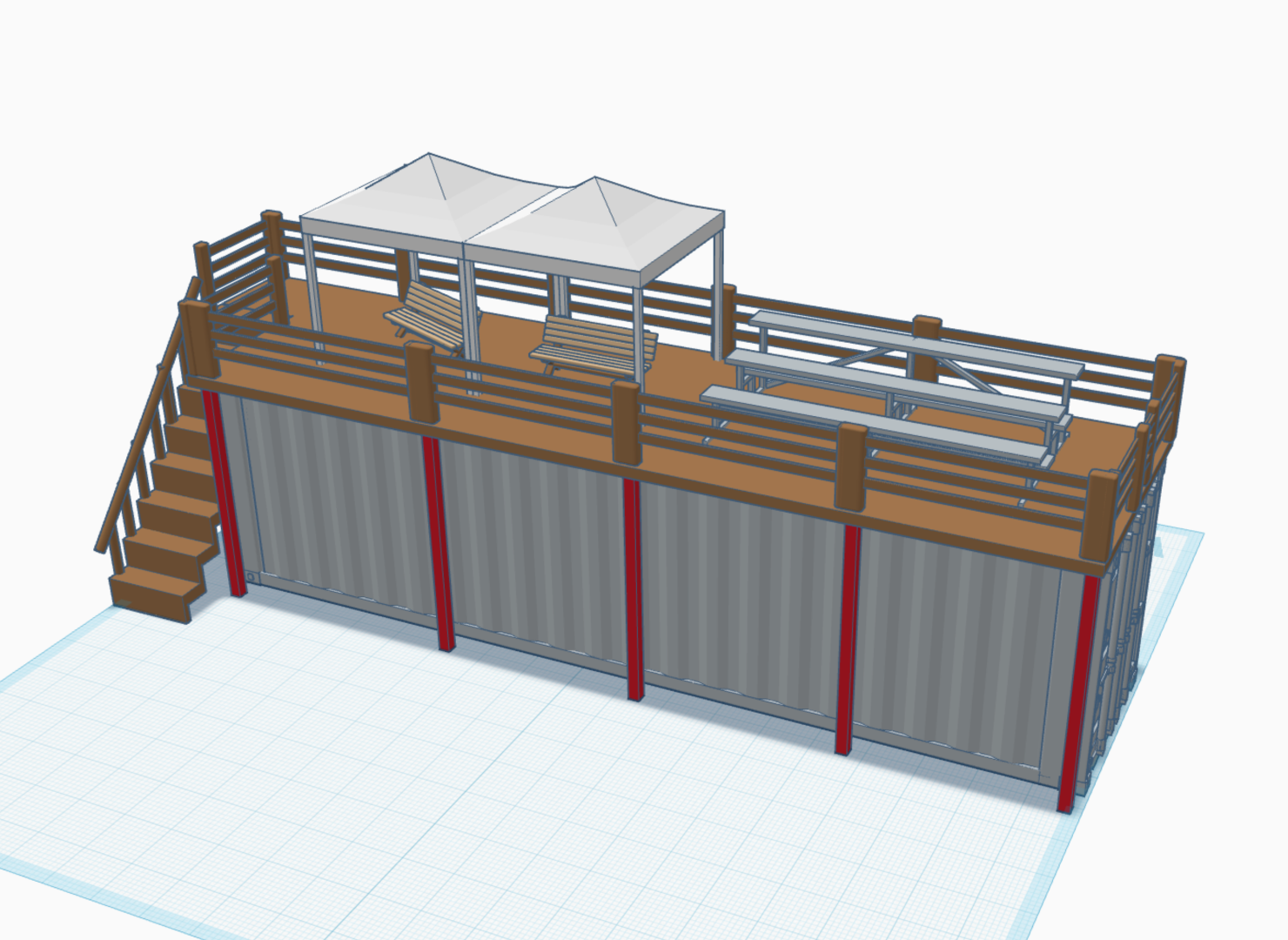

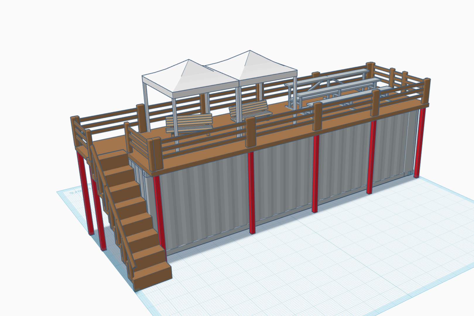

Some updated drawings for interest sake.

This came up a while ago with others I had spoken to. We thought if you can make it handicap accessible, that we could possibly get some money towards it as a grant, if we thought making it wheel chair accessible. A long ramp, ( 1% slope required , would make for a long switch back type of construction, but an exterior elevator is the alternative. They are out there. A smaller set of stairs for able bodied is an easy build. But if we could look in to it for some sort of grants due to it being accessible, that could add to financial coverage.
We really are not wheel chair friendly at the moment. (Any of our viewing stands.)
